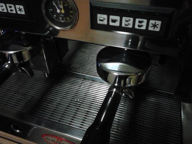

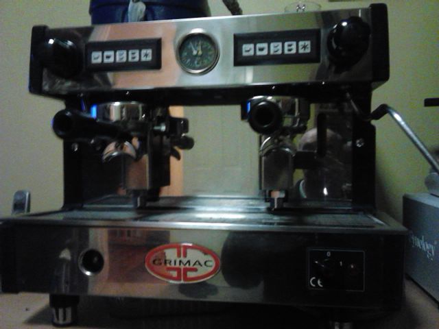

Grimy No More! Machine is now installed and worked to pull a couple shots this am. I gave it a quick spruce up with some metal polish and replaced the cracked waste/drip cup. Then hooked up and put into service. First couple shots could probably be described as 'average' (you reading this Jeff? 😃). I do hope to improve on that, but for now I need to come to grips with different group heads, different baskets, different temperatures to what I have been used to. One group head is significantly hotter than the other when idling - problems with flow through HX circuit? Also it doesn't have a manual start/stop button. I need to use one of the volumetric buttons. To prevent premature shot termination, I will ensure the long double is programmed for a large amount and manually control using that one. It sits with element off 100seconds, then 35 seconds on - running single leg of element 1650Watts. Haven't done any tweaking yet as I want to get to know the beast first. Photos to be attached - easier to type here and add from phone later.
