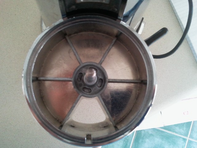

Koffee Kosmo made a snout to suit his Mazzer Major in order to reduce the throwing to the left of coffee (easily located via a google search). He also very kindly gave me a piece of aluminium sheet and some instructions so that I could make a similar mod for my Macap.
After sitting on this for quite a while, I finally started my project. The first thing that popped up was the obviously different design of the dosers. The Mazzer has a round exit chute whereas the Macap has a squarish one, as per the following photo. The exit chute also has a slight taper, which is hard to see in the photo, and made the design of the snout a bit more involved.
