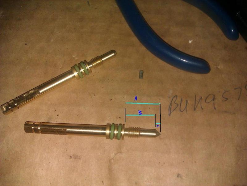

Steam valve part for a NEMOX Opera Not a Lelit Combi PL042
Now if ya can help me out it would be great..  If not then not happy Jan !!!
The steam rod actuall y seals on TWO points...
There is a Flat front face and The valve seat.  The LeIt uses a slightly different thread on teh main valve body and thus the vale that a number of  suppliers have and sell is not suitable.  I know as I now have 3 of them...
Any one want a LiLet Valve rod, I have one or two for sale  ::) ::) ::)
Have tried to email and contact Lygon imports as they are the Importers on teh NEMOX and they receive and read my e-mail but done respond with an answer...
Have emailed NEMOX head office OS, but other than a thank-you for my request; I have had nothing back.
The following  is not a perfect solution ..
But I do have a metal lathe and if I can get the exact measurement from the front face to the valve end or other critical measurements I may be able to re machine and get my mate up and running....
His valve was worn on teh tip and I cleaned up and then had to machine some off teh flat face. I went too far and before I stuff it any worse.... OR it takes months to get a new one if at all, I am left to mode it correctly.
Here is a pic of sorts of the LeLit valve to help you get the drift of the distances I am looking for. But you may need verniers to get the correct measurements as a bit out and ya stuffed.
SO once again.. Some thanks if ya can help me out on this one.

    I was thinking the exact opposite - any chance you could steal the valve seat off a broken Lelit? I believe it's just a T Piece, so then you could use an available part? Not sure if there are many broken ones floating about though, or if that T Piece is available as a spare part.
  • Hi guys, Nice to be part of the Crema Forum - I'll say hello in the marketplace as soon as I can work out how to post there  ::)  Not sure if this will help anyone or not, but we have complete Lelit steam valves in stock. I can't be sure if it will go on another brand as these parts can be different on other brands. But it might be worth a try as a last resort. charlie
