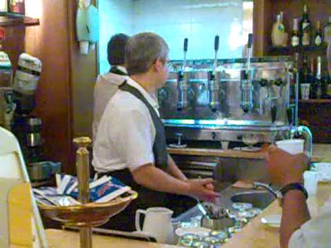

  • Watch this video. At 34 seconds in, the barista slightly lowers the lever, and lets it go, to release the pressure. You can then remove the group handle.

    Same place all the other pressure went.  Though the coffee puck.  ^-^  It's why you get a drip after the pour has finished with a lever, it's the last of the low pressure water being pushed though.  I always slid a cup under the group after I've finished.  Even on a choked pour the lever will eventually come up, but it might be some time. You can also do what Lwowiak said above. :)
