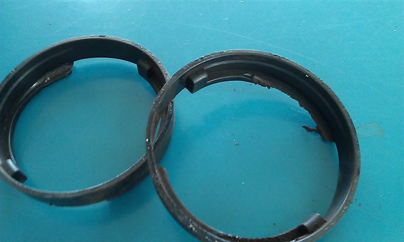

3: PF keeps slipping ... Does not lock in properly ?
Many have a tendency to not just up-dose but to OVER DOSE. Rather than managing their bean freshness / grind / Tamp and manage the dose level to ensue a correct space between the puck and the shower screen. They tend to just keep upping the dose.
This then means that extra forces and physics come into play...
Outcome = The Collar becomes malformed and in some extrema cases is worn so that is almost non existent. Seeing way too many LOL
And a pic just as a taste... for those that need to see. OH and does it not look like the same issue that the EM69xx had ? However it is easer for the service agent to change on the BES900.
