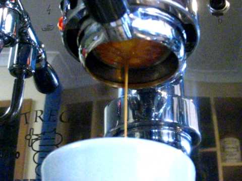

  • My- how the time flies The Bezzera Strega has now been in use for 3+ years Still makes daily coffee Still on its original group head seal ( because I regularly pull it out to clean it ) Still looking like a model in her prime ;) Attachment not found.Attachment not found.Attachment not found.

  • Next in the series of maintaining your Bezzera Strega Lever and other lever machines in general Lever machines don't require chemical back flushing but benefit from daily hot water flushes or a cleansing flush after making coffee My general routine is to remove the shower screen and seal assembly to clean it thoroughly On the Strega it's fairly easy using a thin spoon or one can also use a screwdriver carefully The screen and seal come out in one piece [attachimg=1]  [attachimg=2] Separate and wash thoroughly [attachimg=3]  [attachimg=4]
  • Wipe inside the water dispersion area to remove oils and grinds prior to replacing the screen and seal [attachimg=3] Do the same cleaning procedures for the group handle and basket [attachimg=1] Add a little lube on the seal and replace I have found that the easiest way to replace, is to place the water screen and seal onto the group handle and lock it in just like one normally makes coffee [attachimg=2]
