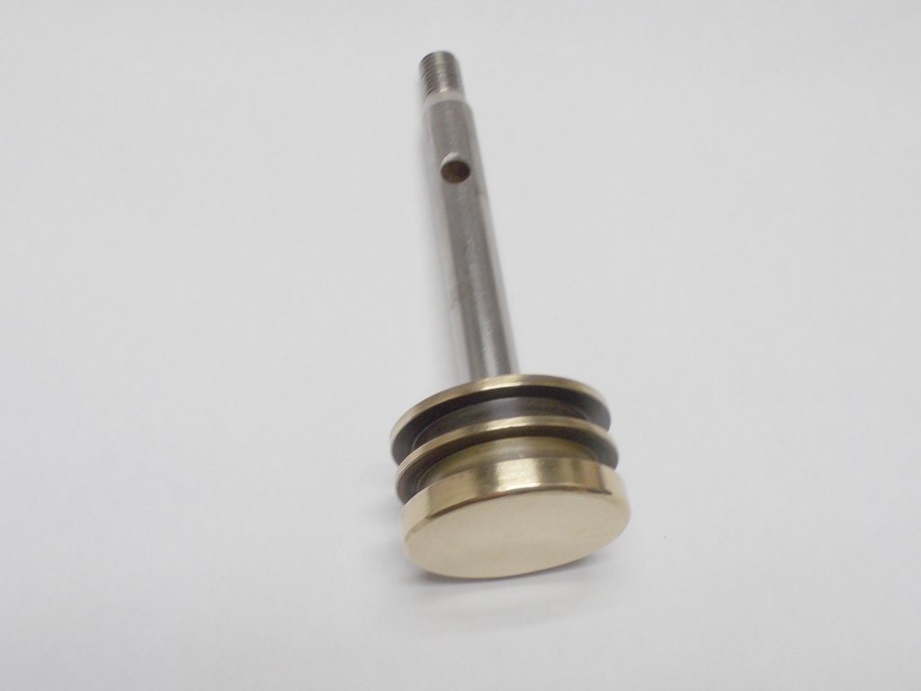

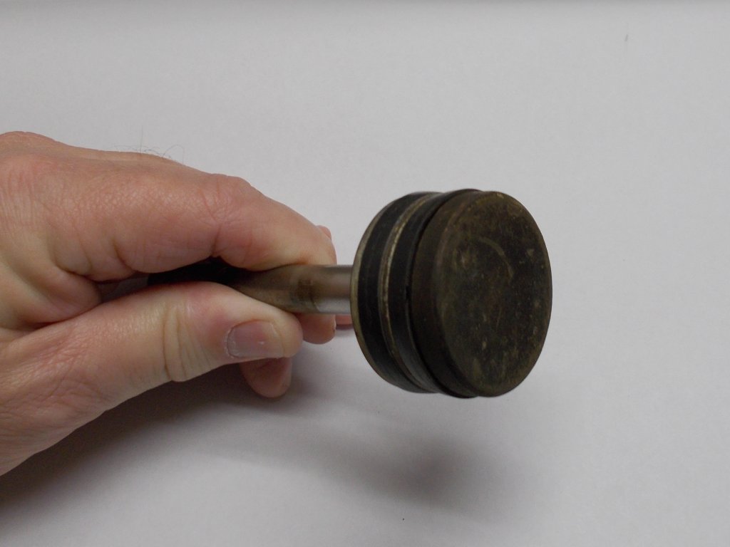

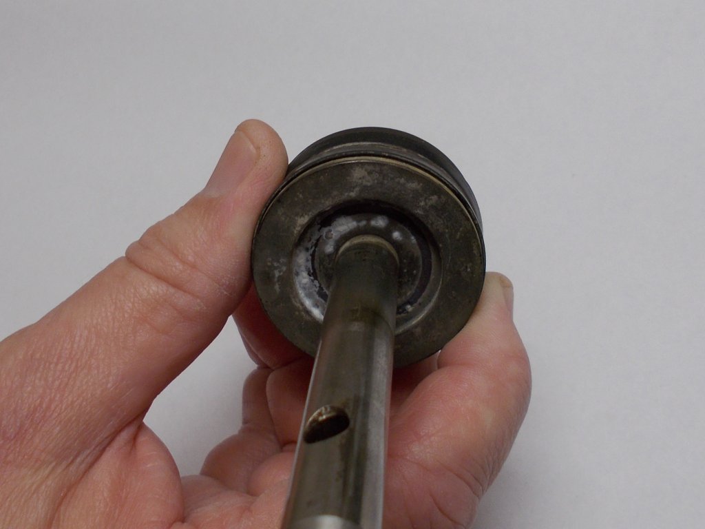

  • We've had a bit of a turn of events. Hubby took the lever off the La Pav as it needed replacing, was wonky- hubby said the piston was seized and the lever had been forced breaking the lever, and once he started taking bits of it led to more bits being taken off and then more bits came off. It was also filthy. I used it maybe 1/2 a dozen times and it was an ebay purchase. There was also a tiny, dead insect in the steam tip lol. In the end I looked at him and said now it is apart you may as well fix it yourself. So, all the gaskets, lever and lever pins are ordered and I think he is secretly looking forward to getting stuck in. Will post a pic of the piston in a bit.

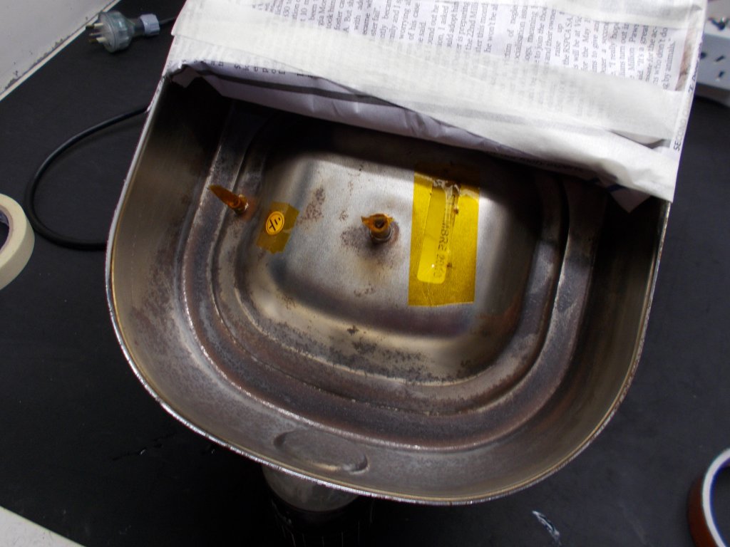

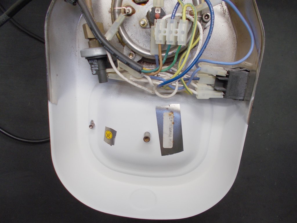

  • We've made a start but have hit a hiccup. The group sleeve is going to have to come out and be replaced due to corrosion and scoring. Part has been ordered. LaPav001.jpg LaPav002.jpg LaPav003.jpg LaPav004.jpg LaPav005.jpg LaPav006.jpg LaPav007.jpg LaPav008.jpg

  • Hopefully all the clips are fine, I did ask hubby before I put it the order for the sleeve and sleeve gasket. Unfortunately I don't think she has been looked after. She is a September 2010 model. The piston was seized, the lever pins were rusted in, there is scoring in the sleeve from the piston. The rust under the base I was not expecting. Add to that all the crap that came out of the group when we pulled the shower screen out, not to mention the dead insect in the steam wand lol. I bought it around three years ago so it would have only been around six years old, of that. I only managed around 6 shots out of it before it started leaking. After seeing the condition of it I am quite grateful for that lol.
