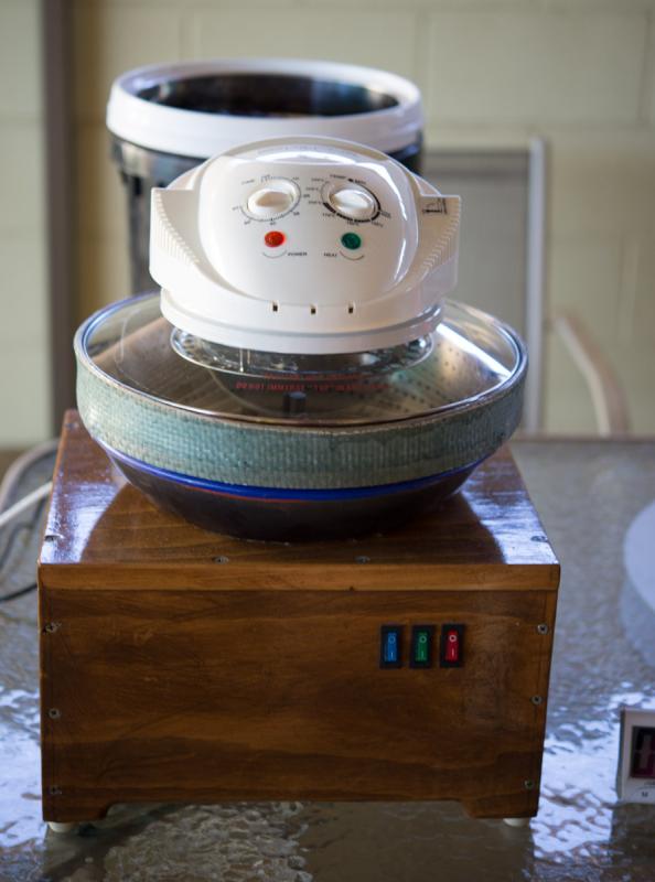

Gra wrote:
Well I roasted again today with the halogen turbo and the thermostat was going on and off every 30 sec with a rate of climb 5-6 sec per min
Hi Gra, 5-6 degs per minute sounds a bit slow, unless you were purposely slowing the temp ramp down. What was the batch size - was it a big roast? What drop temp are you starting from? FC at 15mins, assuming a ramp of say 5degs/min suggests you're starting somewhere around 120degs? The last roast I did (1kg Harfusa) had a similar FC at around 15mins, but I started from about 40degs, and have to interrupt to keep the ramp down to under 15degs/min until it gets past about 120degs. Then at this batch size, it sits quite happily at about 10/min. (see profile below) I might do a dummy (empty) roast with my new one and see what it can do. I seem to remember doing temp ramps of more than 20degs/min in an empty KKTO, when I first tested the Tiffany (solid element & before it was modded)
