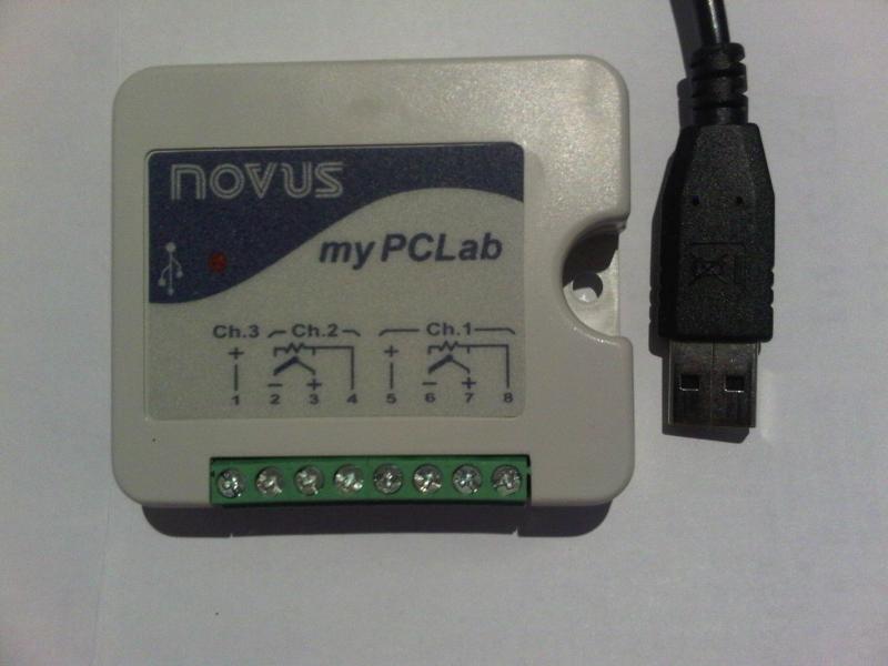

I have just received a new data logger - myPCLab from Novus Instruments, it looks a great device.
I have just setup it up under Win 7 64bit, setup was a breeze, drivers went in, software loaded smoothly, setup of the device, setup of inputs, it all just worked so smoothly, I am very impressed. I will be fitting it to the CCR roaster this weekend.
It is a modbus device so it runs with Artisan 6. At present I have it setup with 2 type K thermocouples, it can also take types J, T, E, N R, S, B, PT100, 4-20mA etc etc,. Brilliant.
It has 3 inputs - 2 for thermocouple and 1 digital. And there is also an internal ambient temp sensor that can be plotted.
I have just been running it at ambient temp, setting up some sampling times, setting offsets - you can vary the offset between 2 thermocouples as there is usually a slight difference. I have only run this up to about 30C but the graphing looks good. It will be interesting to see how the lines track at roasting temp.
USB connection, USB powered.
This device is small, comes ready to install on the computer, it has its own software you can use for logging but is ready to run with Artisan 6. There is a tiny bit of setup reqd for Artisan but it is well documented, you just need to read it carefully.
