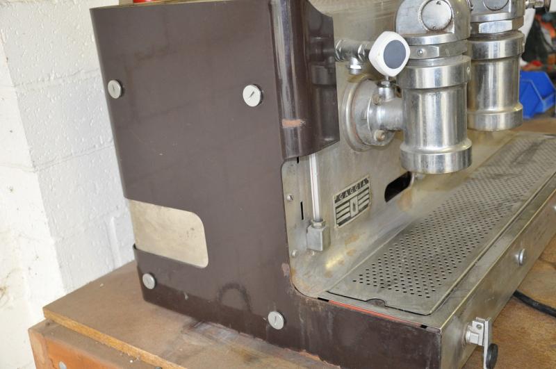

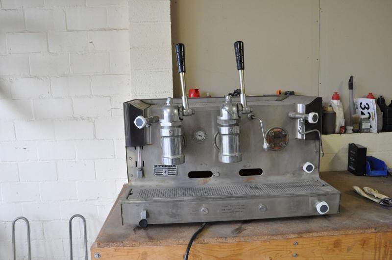

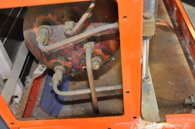

As a new fan of levers I'm loving my L1 and have greatly enjoyed the various lever restoration threads. This brute appeared on ebay last week and I decided why not.
[attachimg=1]
This machine was in use in a commercial environment up to about 10 years ago. Picked it up this morning and I am currently in the process of pulling it to bits. Interesting observations so far. It appears to be in a relatively good condition. The groups came off easily and it appears the boiler and element bolts shouldn't be a problem. Only one of the levers has free movement. Bearings appear sloppy and double gaskets have been used between the boiler and the groups. I may be missing the wobbler weight but I don't know enough about these yet. The mercury switch appears to be in a good clean condition. I do need a replacement steam wand and also a sight glass cover.
At this stage my plans are to sandblast and powder coat the frame and body panels. brush finish on the stainless and rebuild and rechrome the groups. Not sure if I will clean up the reserve group yet. If I can get another lever group then I would prefer to make it a three group.
Not sure what I will do with the machine when its complete. Its way too large to replace the L1 in the house. Also apparently it needs 32Amps. I may replace the elements so I can run it off 15 or 20 amps.
More photos and info to follow.

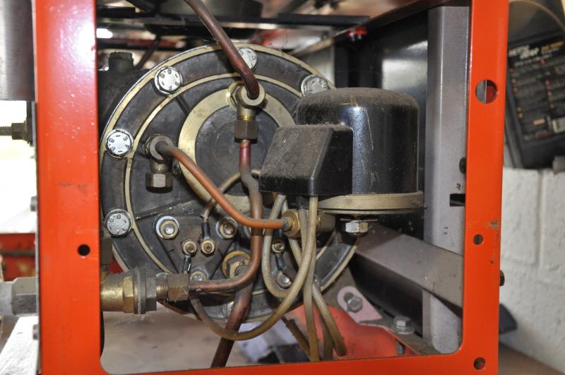

[attachimg=2]
[attachimg=3]
[attachimg=5]
[attachimg=4]
[attachimg=6]
[attachimg=7]

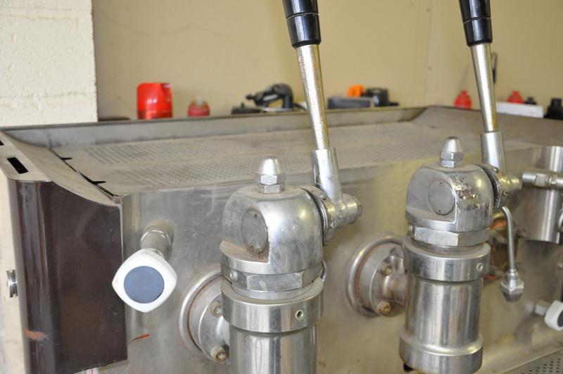

  • Managed to remove all the group studs using the double nut method. Boiler and heat element threads and studs are all good. Do you think I need to do anything with the boiler? The guy selling the machine said it needed 32 Amps. I think these elements are 1750W each which at 240V should be about 15 amps. If I run a couple of 2 group elements then I would be looking at 2500W total which may be achievable with a standard 10 amp supply. Not fussed about heat up or recovery time since this whole exercise is nonsensical. Naturally I will have my electrician verify the logic and wiring before I proceed. [attachimg=1][attachimg=2]
  • Got the groups open. They don't look too bad but I need to give them all a good clean to see where I am. Unfortunately the large hex nut on one of the groups is seized. Can't recall if I read on a previous rebuild that only food grade materials can be used within the group. If this is correct I may to find a big spanner or alternatively clamp the hex nut and bolt the group flange to a long piece of wood to provide a bit more leverage. [attachimg=1][attachimg=2]

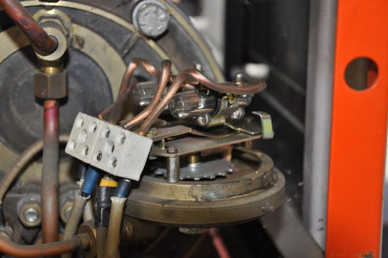

  • Hi I'm having problems in that the pressure-mercury switch is not holding pressure. It appears that the pressure switch is manufactured in two main sections which are threaded and a diaphragm is sandwiched between the two. The diaphragm appears OK but I have leakage on the main thread. Before I use brute force to open this can anyone confirm that these can actually be opened and if some form of o ring is required. Thanks [attachimg=2][attachimg=1]
  • PM sent with contact info for parts, Can't help with that Pstat sorry as mine had the wobbler weight and was converted to Sirai. The contact details i sent you may be able to help with that pstat though. Good luck
  • I know that Bezzera use a special high temperature - food grade - non hardening - thread lock sealer Hope this helps you in your build The one I would recommend is the Permabond A131 But do your due diligence and research it for suitability http://www.permabondllc.com/TDS/A131_TDS.pdf Attachment not found.
  • Inside the pressure switch. The existing gasket is quite hard, brittle and now broken. I'm sure any high temp material will do the job but I am starting to lean towards a sirai pressurestat. Also I appear to be missing the wobbler weight and the machine was equipped with what looks to be a spring loaded pressure relief valve. [attachimg=1] [attachimg=2]
  • If the machine had a functioning pressurestat, there should be no need for a wobbler weight, but some still have them as a safety feature. The valve you have pictured is a standard safety valve, which has a spring and a teflon seal normally. You can just replace the spring and teflon seal, but most people just replace with a new valve - Note ; gaggia use a 19mm safety valve, not the more common 3/8"
  • I can vouch for the Sirai pstat.  Not expensive and the dead zone on mine is less than 0.2bar. Bezzera also have a combo safety / anti-vac valve which in my case saved me having to plumb in another connection.

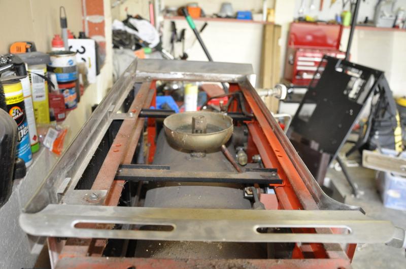

  • Frame and outer panels are at the sandblasters prior to powder coating. The stainless steel panels, trays and other components are with my favourite fabricator for refinishing. I have ordered the element gaskets and boiler basket and am having the boiler to group head and the mercury pressure switch gaskets fabricated. I also have new bolts for the boiler end plate. I couldn't get engineering studs for the groups and elements so I plan to cut these from a length of 316SS M8 threaded rod. The machine was originally supplied with brass nuts to hold the group head so I have purchased SS dome head nuts. Since SS to SS can be a real pain I also picked up nickel based antiseize. I will have a bit of a go with polishing the boiler and piping but pretty much now have the frame, external body and boiler area under control. I plan to have a play with the mercury switch once I have the new gaskets and will decide once I get a feel for the consistency of the switching pressure. I will replace the pressure relief valve but to my surprise my unit and I think many other older gaggias are not equipped with vacuum relief valves. I assume that these units are started up with a steam tap open. I have various spare ports so I will also install a new anti-vac valve. The groups are mostly apart but the pistons are seized with the connecting pins. I will give them a few days with WD40 before I apply heat. I have ordered new springs but wait until the groups are properly apart and cleaned before I do much further with them. I haven't touched the reserve group but I know it has a broken handle. At this stage if I can source a third lever group I would be happy to ditch the reserve group
