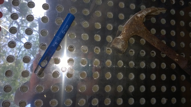

Put the mat on a wooden board and lay the cup tray neatly in position upside down on top of the mat. Then use a hammer and a hole punch (just a little bit smaller than the tray holes) to punch out the holes keeping a little pressure on it all so it doesn't move.
[attachimg=3]

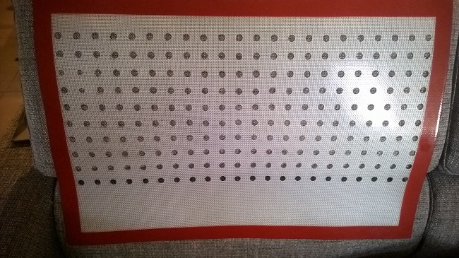

Once you have punched all your holes.
[attachimg=4]

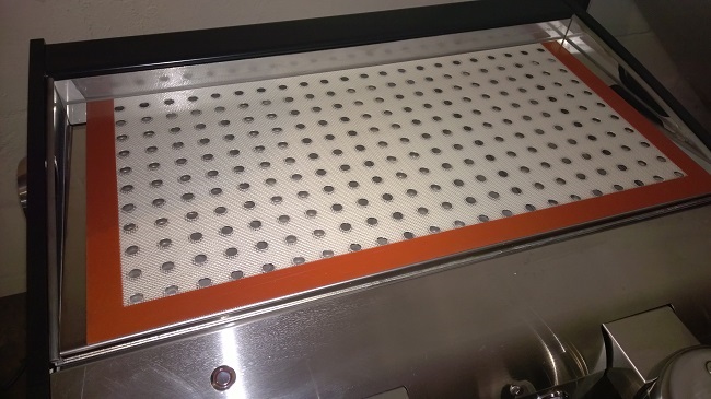

Lay it back in position on top of your cup tray, mark and trim back edges to suit. (I didn't need to trim the side edges)
[attachimg=5]

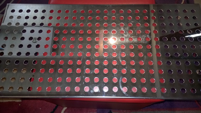

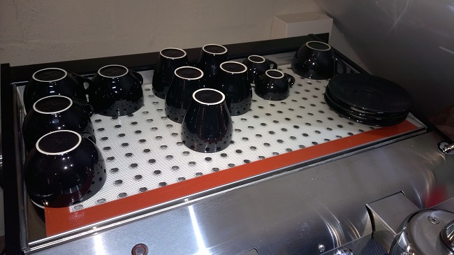

Give everything a wipe over and polish the cup tray, refit the protector and put your cups back on.
[attachimg=6]
Job done, have a coffee. Protects both the tray and your cups for $15 and an hour of your time.
