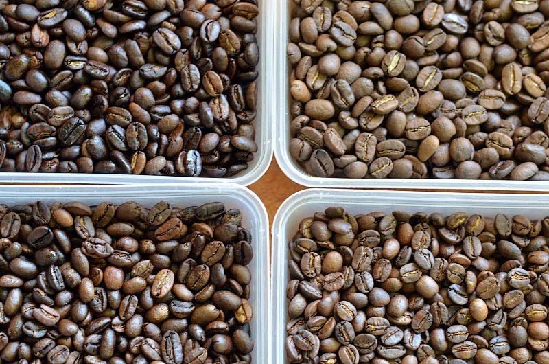

The photo below was from October last year. I was experimenting with roasting a bit lighter than I'd mostly done in the past. I got a bit distracted on one of them (I often multi-task when roasting and check in while doing other things, and/or keep an ear on it) and it got a bit darker than intended but it tasted OK. In no particular order, there are Brazilian, Honduran, Ethiopian and Sumatran beans in the photo.
I hope my post helps. I'll answer any questions you have of me, with the disclaimer that I'm only someone who enjoys a bit of home coffee roasting and drinking.

Here is my first roast after the stirrer arm mod. It does improve how even the beans look....
150g Costa Rica green Beans
1st crack: 9.30min
2nd crack: 13.50min
Roast: 14.15min
Lelit PL PLUS, Iberital Challenge Grinder,  VST18g Basket, Baby Roaster FZ-RR 700

Great to see of your progress Laurent. The last pic you displayed looks like the best so far.  :thumb:
Let us know how your first two roast batches tasted.
If you dont like them as espresso based coffee, then try a filtered coffee and compare.
As shown on my video, medium heat at the start for the drying phase, then higher to medium to high heat, then anticipate to slow down the heat just before first crack, then cruise til second.
Those guys are right. The roasts taste great even taken right into second crack.
My preference is still just on the cusp of second as I like to experience both roast and origin characters for balance.
Keep trying Laurent.
Certainly do think about building a KKTO too. You never know, when your friends enjoy your coffee, you may wish to roast for them so that they can pay for your coffee habit, that's where the KKTO and coretto comes in with their bigger batch sizes.
They are a great roaster since I also have them both together with the coretto.  :thumb:

Baby Roaster Costa Rica today using some of your previous suggestions
No shaking due to stirrer arm mods
200g green
1st crack 10.45
2nd crack 15.20
Roast time 15.45
I feel that heat control before 1st crack is key and you were right 200g seems to improve evenness
Come on Gary some encouragement please (he is a tough judge!) ;)
Laurent

Looking lots better than the previous attempts  :thumb:

 ??? I felt my ears burnin..
Oh hey, you know, better to tell it like it is rather than be too nice and say yeah sure that'll do.
You may know the song that goes..." You gotta be cruel to be kind, in the the right measure, cruel to be kind, it's a very good sign etc etc" It's a 70,s or 80,s song, i think..
Judging by the looks, it is the best roast thus far Laurent, well done.  :thumb:
The proof in the pudding is how it tastes, rather than how it looks.
As I mentioned in an earlier post, have you tasted the first two roasts?
How did you like the taste?
200 gm is always the recommended load, you can err less or more but not much more or much less.
Next roast, try and lessen the gap between first and second. Add slightly higher heat setting and go for 3 minutes after first crack. Stop and cool just as you get 15 to 20 seconds into second crack.
I'll do a roast on Sunday and put up another pic.
Or, maybe another video. Wan? :)

Tastewise: all  drinkable so far.
The first couple of roast with Brazilian were quite average though.
The last roast with Brazilian was the best tasting one (even though looked much less even as was done before stirrer arm and heat control)
Then I changed To Costa Rica beans which are -to my taste- much stronger with less fruity notes so I use them for my cappuccino. Not as enjoyable as true espresso (no sugar no milk). So I have tried the same beans roasted on the KKTO (big thank you KK). KKTO roast looks perfect but the taste -even though a bit better than my roast- is still in the same strongish notes. All this to say that taste-wise I think I am on the right track.
Cannot wait for roasting some Columbian supreme next...
Cheers
Laurent
