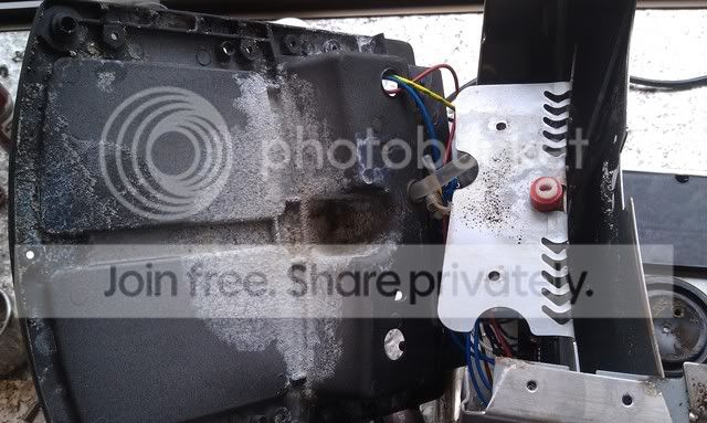

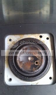

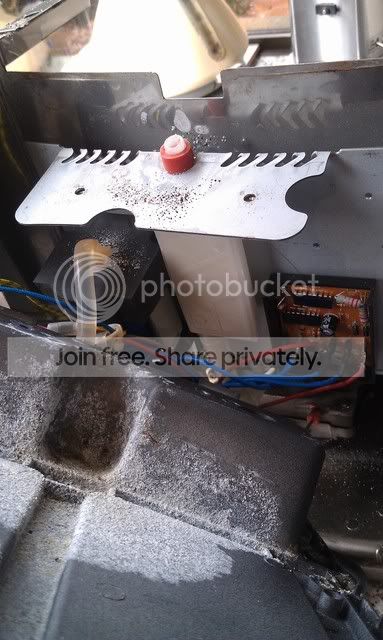

  • Hi all i'm new here just trying to see why the coffee machine i purchased for my girlfriend has starting making loud noises and not pumping properly. It hadn't been descaled in about a year so i thought this would be the problem. I tried to undo the screw to get the brew filter out but it was stuck and i rounded it. I thought i would take the machine apart and maybe i could get at it from another side, i was wrong. Inside i found a heap of crap that you can see in the picture. I presume this is a result of the old drip tray that rusted through due to it being the wrong type of metal. I had another attempt at removing the screw and it snapped, leaving half of it in the machine. Any suggestions. IMAG0169.jpg IMAG0170.jpg IMAG0171.jpg
  • Thanks for your response anger management i appreciate it. I think i have managed to re-size the pics hopefully you can see them ok now. I really want to avoid having to buy another machine as we only just bought a new drip tray last week which cost $65 and i'm a struggling student(4th year electrical engineering). The scale in the pictures is underneath the tray section so it would have been caused by the dodgy old tray, so fingers crossed it looks worse than what would be inside the thermoblock. Further information that may help is that steam arm seems to work fine, its just the brewing that seems stuffed(not as much water is flowing and noisier like the pump isn't getting enough water). The only descaling was using some vinegar/water mix, i have never changed nor do i know what the group seal is. The machine does not get a lot of use maybe 3 or 4 cups of coffee a week.
  • I reckon you would be better served by a manual coffee making device like a aeropress. For 4 cups a week its hardly worth turning it on. I would have thought being a student 3 or 4 per hour would be more like it  :rofl:
  • whereabouts are you? Could be a duff pump - works ok without pressure, but unable to push against back pressure when brewing. can't quite see from the pics. Is the broken screw the one  in the centre of the brew head? There are ways to remove screws, but you will need to have clear access so you can get  to it. drilling the centre of the  screw and using a hex key tapped info the drill hole sometimes works - also, as am says do it hot. I wouldn't waste time on the screw unless you know that everything else is fixed, because machine may not be worth fixing.

    I'm in Perth, and yep its the screw in the middle of the brew head. Would it be worth me taking a video of it in operation, for you to look at?
  • on 1334821027:
    My gut says clogged ceramic switch plates and MAYBE partly clogged thermoblock. It uses the same path, just switches in the different thermostats for Brew Vs Steam. That being said any crap in the ceramic switch plates can cause a high back pressure... Thus pump will struggle / stall. Also steam will travel through the thermoblock, even when partly clogged; but water will not ... Thus pump will struggle / stall. As it is in bits... I would check the switch plates but take care !!!!!!!  AND maybe as a first option; I would run a couple of descale runs but in steam mode and DO IT OUT SIDE...  Especially if using a quality descaler... The descale may move clear the thermoblock if that is the problem and on the second hit; changing the switch over etc may move any crap if its in the switch plates... As the screw is broken deep in... It will be a pain..  Removal of head etc and drill it out / re tap and a new SS C/sunk screw. Lot of effort.... If you have the tools; worth a go.  If having to PAY for it to be done...  Go the upgrade path...
    I put it all back together, yesterday and ran one lot of vinegar/water mix. After putting probably a litres of fluid through it i got a few speckles of contaminent but nothing to write home about. Will have another go on the weekend, are the tablets much different to cleaning vinegar(both are recommended in the sunbeam manual)
