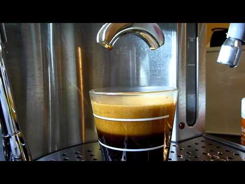

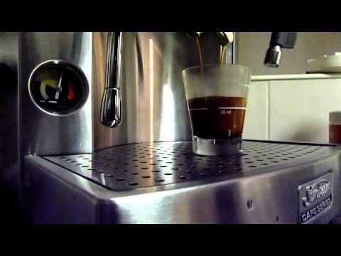

I have made what I feel is a huge advancement. Thanks to Muscles and his generous off of a 22g Synesso basket. 22 grams, I think is just a little too fine, almost 60ml in 30 seconds. The taste, the way I would describe it is smooth and rounded.
I just have to say this: WOOHOO!!! For people that have this combo, the EM6910 and the EM0480, get a synesso basket, you won't regret it. As everyone knows the grinder has been driving me nuts, then it clicked, Muscles said use a slightly finer grind, that is all I can get out of the grinder anyway, sooooooooooo I thought I'll give it a go, one sink shot later and holy cow, thick, dark brown crema, granted 60ml in 20 seconds so maybe might be able to go finer again but the outcome tastes great

I'm always interested in the difference that such a small amount of ground coffee makes. I'm using the 22 gram Synesso basket with the Spong. If I put 22 grams in, I knock it down half way then put the rest in, tamp, I tend to get the extraction sitting at 12:00 or just after, which is fine, dark, syrupy flow. I changed the amount and what I did tonight to see what would happen. I put 21.6 grams in, I just piled the grind in without knocking it down until I tamped. The result was 11:00 and although still slightly syrupy the flow was light. Interesting though below is what happens when it settles, I still think it looks good, it's the Harrar/Rononi blend that I did.
Not that good AM, I don't think the blend worked, it's ok but not as smooth and sweet as the original blend I did. My OH seems to like it, although I have to say, when I make his coffee it's always fantastic, my own, I don't know what goes wrong ??? ;D
