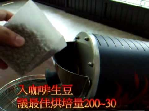

    Hi Gary welcome to the forum I have found a cut away photo of the element section nakedsiang.jpg Also a video of the screw section It actually looks more like a fan blade ( look at 55 seconds into the video) [embed=425,349] KK
  • HI Kk Thanks for this. Its something I have seen before but does not give me the detail I require to see how efficiently it works.For the beans to be 'circulated' from the rear of the drum to the front continuously on the same plane via a screw mechanism. The drum rotates, the blades rotate differently. Id love to see it working. If it is as good as it appears, this would be great in a one kilo or more machine, and as such I would be asking them to consider making one for me :) best wishes g.

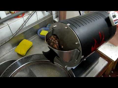

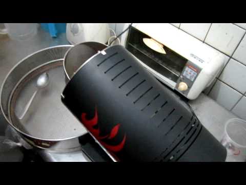

  • Sorry guys, I was busying on finishing my thesis and barely check the forum for a while. For response the request. I am loving this roaster so far. Only small problem I have is the noise and stuck some time. For some reason when I use  smaller bean, they will get stuck in the middle of some where and the drum stopped. I have to shake the whole machine. And also there is a weird vibration happen when I put the drum on my camping stove. The vibration from the motor of drum will pass through the grill and produce some annoying noise. I have to put some thick paper (wont melt) under the grill legs. I have contact with the maker about the noise, but no reply so far. Probably he think that is rare case. That is the facebook page for the maker. http://www.facebook.com/RotateFun300 I believe he can reply in English. About what Gary asked regarding the efficiency. I always use more than 300g for the roaster. 350-400g, 400g is the maximum. It will have problem to mix properly when over 450g (twice in my experience). Some part will burn, and some part still unroasted. Otherwise is fine. Small thing happen here is the heating method I use is fire. Its quite difficult to maintain and duplicate the heating progress. I plan to put a heat gun which I use for my previous breadmaker/heatgun home roaster. It is easy to duplicate the result. I will post the link to maker's facebook. To see if he can response officially. Colin

  • I will post some photo or video this week. And before that, people probably can check the maker's facebook. http://www.facebook.com/RotateFun300 There are few other users post their working condition. I have to say I were just impatient with the 300g loading, so I start to experiment 350, 400, and 450g. 400g is my standard roast load, which I did not see any problem with this roaster. The reason of uneven roast after 450g, I will say its the mix problem. From what I can see when I overload this machine, the bean from outside (which design for observing bean's appearance) wont come back into the middle of roaster. And the bean in the middle can not come out or only small amount could come out. That makes the beans in the middle reach the 2nd crack, the outside one is still under roast. I can post some video too (without fire on, of course). About the inconsistent roasting profile, I will say its my stove's issue. I thought its quite common for home roaster without air circulation? So the only way I can adjust the power is the tune of stove. Then I could not keep the same heat with the basic camping stove. That is why I have try the heat gun few times, and the result is better and consistent. The downside part for heat gun is no place to fix the heat gun from top, only from bottom. heat_gun_roaster.jpg However, the problem for the second one is few of the heatgun's air intake is blocked (on the floor). And its difficult to adjust heat gun either. I will say for people live far from Taiwan probably not worth to buy it until it has been commercially produced. But it definitely a small handy roaster for my experience. Colin
  • HI Colin Instead of placing you gun like you do, there is an attachment you can use to deflect the heat into the chamber whilst having the gun 90 degrees to the drum. If you dont have anything suitable in the kit, use the fish tail and add a piece of metal on the outside lip at a 90 degree angle so that the air hits the metal and is directed up toward the drum. It will work fine. Failing that, make a small metal box that fits tight on the bottom of the RF300 and cut a hole in the side and insert the gun in there from the side. The heat will be more than enough and the air flow adequate. garyw
  • As Gary noted To incorporate the heat gun as a heat source Adding a box will act as a heat sink and instead of heat escaping to the envoronment will be used more economically My thoughts are for the box to run the length of the outer drum for best results Small exit holes need to also be incorporated for escaping air  KK
