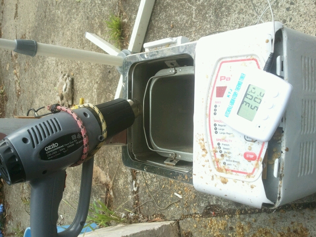

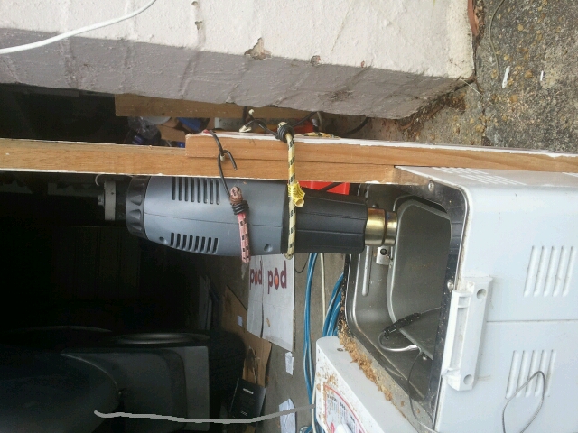

First step - manufacture a stand for the heat gun. Two spare bits of timber (old skirting board) were used.
One I drilled and screwed to the breadmaker casing, the other I mounted on the inside of the first so that the heatgun would be pointing inside the roaster pan. I could have used a single piece of timber and a spacer, but this seemed cleaner and sturdier.
Next mount the heatgun. Two bungee straps worked fine for this, although I had to adjust the length of them to get a tight fit.
Finally mount the temp probe. This was where things went a bit wrong and I lost precious time. I intended to use a piece of wire across the top of the pan as a support with the probe then pointing into the bean mass. Unfortunately this didn't work and the probe kept bouncing around in and out of the beans, so acccurate temp reading would have been impossible. A quick rethink and I grabbed the clip for my milk thermometer to hold it against the lip of the pan. At this point my time was up and it still wasn't fully secure, so I didn't QUITE manage the goal.

Used a bit of insulating tape to hold the wire from the temp probe against outer casing of breadmaker such that the combination of clip and tape stopped movement - approx 30 seconds after my original goal passed.

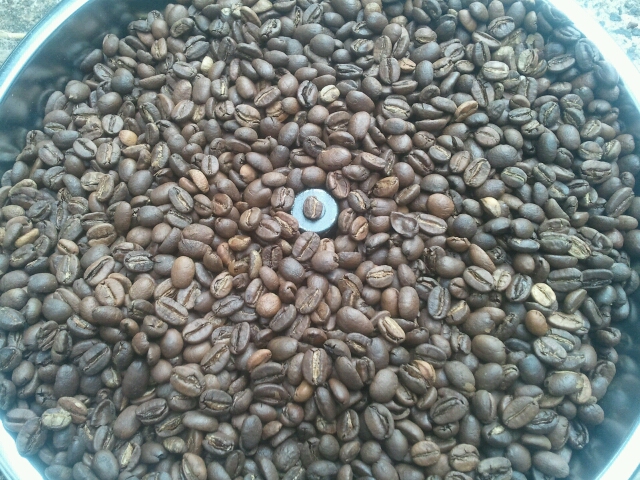

Let it run for a further 3 mins and pulled just before second crack (estimate).
Will post up photos of the setup and final roast shortly as they are on my phone.

Edit: photos added. Rather uneven roast compared to hottop, but hopefully still drinkable.
