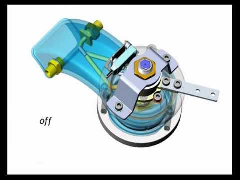

  • Ah ha... Found it! This is the La M video which shows that they don't infact pressure profile like a slayer: I sure hope Ronin will be along soon because I think that he is wise in such things.
  • Nice one Brett, I didn't realise the LM paddle was only pre infusion, always assumed it was pressure profiling.
  • So basically if you want pressure profiling on anything other than a non-manual lever then it's either a Slayer (there's one on the bay fir $15k) or DIY ala C-Man!
  • Or possibly an external pump and a flathead screw driver :-)
  • I'm no expert but I think even the slayer is not variable pressure. If so its only the LM strada that is. There is some play in the LM preinfusion. Works on line pressure, open a valve basically & can open it fully or partially for some variation. Then Turn pump on & can go back to line pressure. I think the idea was to replicate a lever type of result. Sorry bout short reply. iPhone to slow
