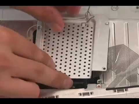

  • I think my wife tried to open it with a knife, making the marks but never got it open No meter, I even took the power supply to electronics place to have them test it but they would not do anything I used this video to open the keyboard, same unit. It looks ok, could use a clean I guess everything is soooo tiny and hard to see even with glasses and a magnifying glass. will clean any contacts with isocol  I guess? I need to test the power supply somehow?
