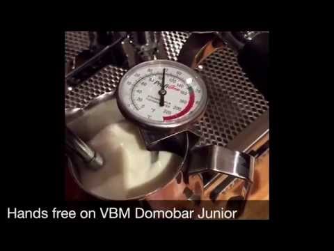

  • Resurrecting an old thread here. Yes I personally steam milk better with a smaller jug. The jug I mostly use is a 450ml motta knock off. It's thick gauge stainless and goes perfectly with my 2 hole steam tip on my VBM Jnr. Perfect for 2 lattes. I'm also pretty good at steaming milk in a 1 litre jug but this was with a 5 hole steam tip on a commercial machine. I then split the milk in smaller jugs for pouring. Here's a quick video where I just steamed some milk with awesome microfaom for a flat white - all done hands free.
  • That's pretty much the method I created several years ago Have a look at my blog and posts in many coffee forums to verify This is the blog link and don't forget to click on the video - http://koffeekosmo.blogspot.com.au/2010/11/koffee-komo-method-to-creating-great.html KK
