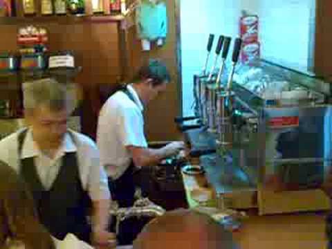

    That tamper was a special match to a hand picked LM basket I have found since moving sideways to a lever machine that I needed to grind a little finer This is the result I get with a naked filter - video http://m.youtube.com/#/watch?v=RzZBM1C4daQ&desktop_uri=/watch?v=RzZBM1C4daQ KK
