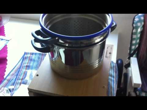

  • I've got to say this drive shaft and motor is causing me a great deal of grief. [embed=425,349] Plus it's now rarely making it up to full speed. I've read about it elsewhere and have seen it in action - the motor starts at a slower speed then switches to the faster speed. Mine's no longer switching to the faster speed.
  • Personally I would be exchanging the motor for one that works and also seek a window winder motor I suspect that the gears or worm drive mechanism inside the housing are binding KK

  • Mine starts like yours and I have to apply pressure to the agitator in the direction that it's turning to get it to speed up.  Mine turns clockwise and will only turn at the lower speed anti clockwise.  Give it some tough love and force it o turn faster.. that's how mine works.

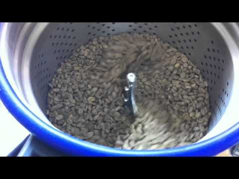

  • Thanks for that Brett, that got it working! Here's a test without any beans: [embed=425,349] And here's a test that I left running for 30 minutes with 600g of green: [embed=425,349] A couple of points:
      [li]I've definitely still got some driveshaft alignment issues - the holes between the roast chamber and the insert liner aren't perfectly aligned. I need to fix this[/li] [li]It looks to me as if the older blade (it's slightly darker in colour) needs to be straightened out - the beans on the newer blade are getting more agitated than the ones on the older blade -
    would anyone else agree?[/li] [li]I think I'll do that spring mod. It sounds like beans are getting caught under the agitator blades.[/li] Nevertheless, I think I'll have a go at roasting those beans tonight even as it is. A heck of a lot of chaff was left in the insert liner even on this test run. Not quite as much as I've seen at the end of a full roast, but I wonder if it wouldn't be worth leaving the beans in there to de-chaff for 30 minutes or more, discarding the chaff, then doing the roast?

  • Awesome!!! What weight of greens is in thesecond video?
